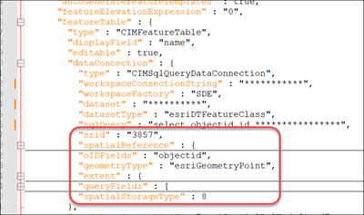

  1. did you create the query layer in ArcGIS Pro? Or you created in ArcMap and imported that in Pro?
Can you pls do this for me?
  • save your query layer as a Layer File (.lyrx)
  • open that in a text editor
  • check if the following properties are written in there and they are not empty
if they all look good and you are still running into the performance issue, I'd need you to reach out to Esri Support to help us reproduce this in house.

Thank you.   I do see those properties populated correctly.   "spatialStorageType": 15  only difference.
The only weird thing I see, which I also noticed in server logs, is the dataConnection.dataset property has an incorrect "%" in there.   "dataset": "maps_db.public.%vw_all_geoaddresses_layer_v1",

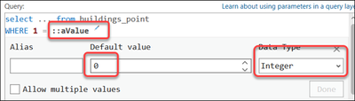

While you will be waiting on an analyst took at this, I'd like you to try this workaround. For that we will use discrete parameter.
https://pro.arcgis.com/en/pro-app/latest/help/mapping/layer-properties/define-parameters-in-a-query-...
the basic idea is to use a sql that won't return any records to define the query layer and at run time we will overwrite that parameter value to return results via map service export/query operation.
the sql will look like this
SELECT <.....> from aTable
WHERE 1 = ::aValue
then set the default value for this parameter 0
That makes the query to return no records. Therefore, in the next page of query layer creation dialog, you need to specify geometry type, srs etc. yourself.
once published, you need to update the value for this query parameter with 1 to make the where clause be like 1=1... and then you can add your other clauses with AND or OR operator...
In map service export call you need to use layerParameterValues parameter. https://developers.arcgis.com/rest/services-reference/enterprise/export-map.htm
for query operation use parameterValues parameter. https://developers.arcgis.com/rest/services-reference/enterprise/query-map-service-layer-.htm
If you use map viewer, you can set these values by using custom parameters option.
