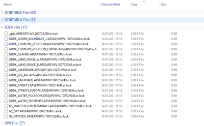

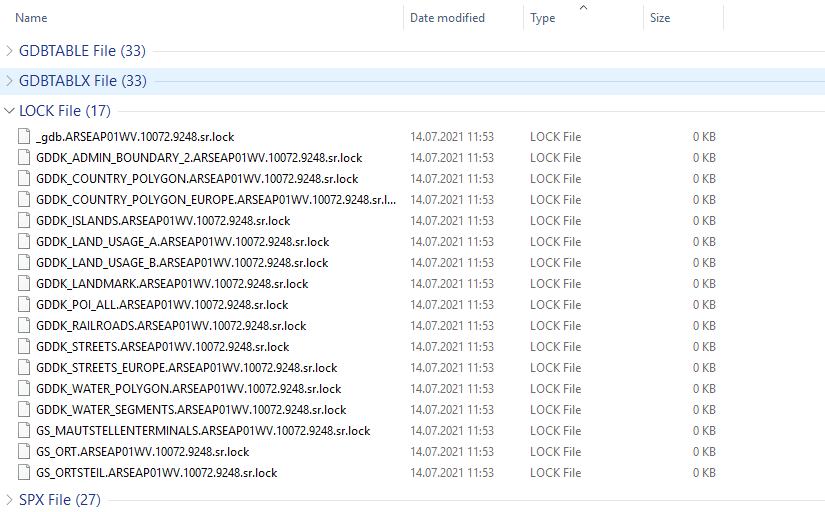

We are uploading a service definition for a new service.Unfortunately we see, that either the upfront update of the service definition or the the publishing results in some unhandled lock files, that will remain and keep our script from coming to a sys_exit ... The python script is still running and running.

The locks are situated inside the gdb that holds the data fro the used mxd. As the script is still running, I can't delete the lock files by hand. only quitting the python process itself (PID 9248) will get rid of the lock files.
