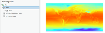

I cannot reproduce the problem using my Pro 2.8 and Server 10.9 with your data. Here are my steps:
1. download your netcdf, run make multidimensional raster layer tool with the netcdf.
2. run copy raster tool, select process as multidimensional, output format as crf.
3. run the exact code snippet you provided to generate the sddraft file.
4. stage the sddraft file to make it a sd file; upload the sd file to server.
5. add the wms endpoint to arcgis pro as a new wms server, the layer displays just fine.
