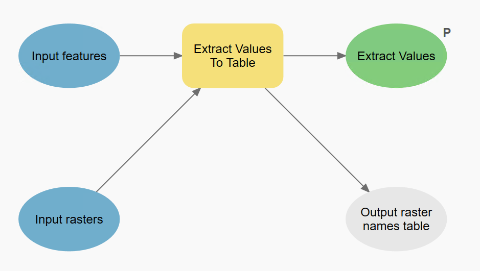

I published a very simple geoprocessing tool from ArcGIS Pro v3.1 to ArcGIS Server v11.1. The inputs are fixed for a test purpose but when I execute it from a Javascript application with Maps SDK v4, it returns very different results every time. At a time, it even returns empty data. The processing time is around 2 or 3 seconds. So, it is mush faster than timeouts.
The model uses "Extract Values to Table" tool and the input features and input rasters parameters are fixed. When I run it within ArcGIS Pro, it produces a table in a file geodatabae with 7092 rows. However, when I call it from the Javascript application, sometimes it returns around 120, 650 or 1200 rows (features) or even zero row.

I'm totally lost now. Even when I submit a job from the ArcGIS REST Services Directory on my browser (Firefox), it returns different results every time. So, I don't think my javascript code is the culprit. Are there settings / environment I need to set properly when I publish the geoprocessing service? Any ArcGIS Server settings that affect how the geoprocessing service is run? Are there any things to remember or need to pay attention to when migrating from ArcGIS Desktop 10 & ArcGIS Server 10 to ArcGIS Pro 3 & ArcGIS Server 11 when it comes to geoprocessing services?
