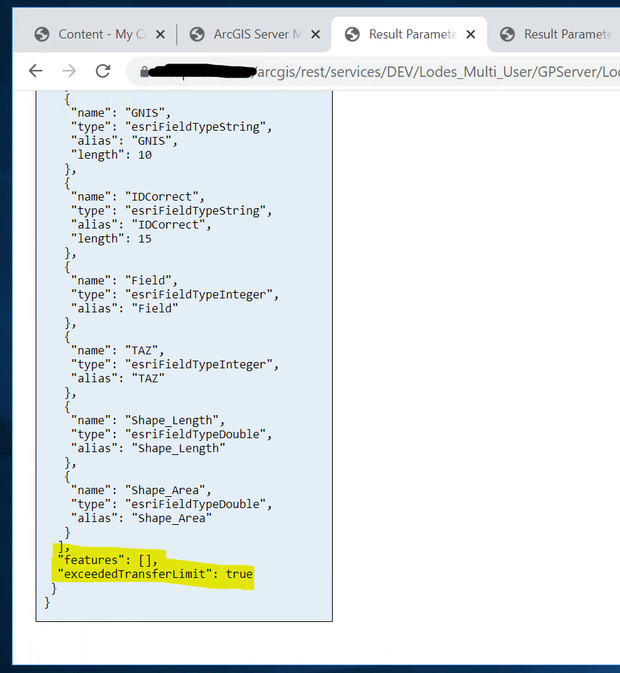

Hello!
I have published a Web Tool to Portal with two GPFeatureRecordSetLayer output parameters. I run the tool with no errors but the output is always empty and the exceededTransferLimit property is set to true.
When I look at the output of the job in the arcgisoutput folder on the federated server, the feature classes have been created successfully. The gdb is a modest 200KB in size and the two feature classes have 8 and 19 records. The max number of records for the service is 1000.
I have similar web tools published to this portal that execute successfully without exceededTransferLimit getting set to true.
Any ideas on how I could troubleshoot this?
