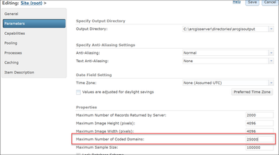

pls try bumping up the value for 'Maximum number of coded domains' for your map service from the Manager site.

It's working perfectly fine.
