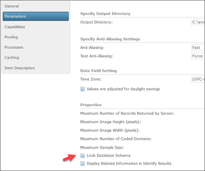

I agree with that @MichaelVolz says. That said, if you really need to do what you said you would for some reasons, you can turn off the schema locking from your service setting that should allow you do data swapping without stopping the service.
That said, we always recommend users to be aware of what they are doing when they turn off data schema locking.
