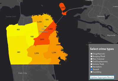

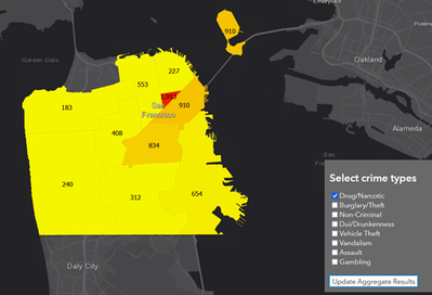

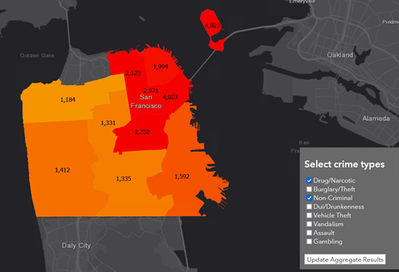

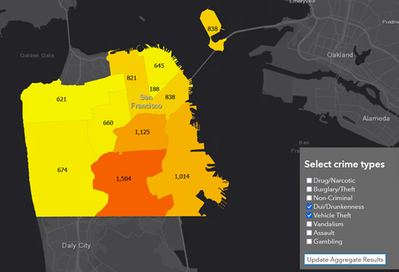

This will allow you to aggregate data for any slice or combination of slices. In my example, it is showing total crimes per districts for selected crime types. These results are generated dynamically -- as you realized the polygon layer does NOT have any crime related attributes. I have a point layer that represents crime locations and types. For each request, the results are aggregated dynamically from the point layer and being joined to the polygon layer to visualization.
