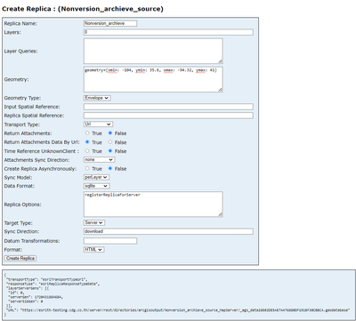

Hello @Diana_Muresan  I saw the blog One-way feature service-to-feature service sync and do the following workflow. However, The replica ID from the source service not same as replica ID with target service.

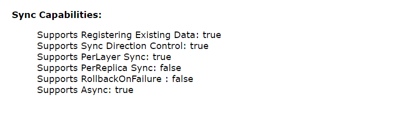

I have published source and target service however, I don't see the property of  "supportRegisterReplicaForServer : true" as you show in the blog, In my service show the SyncCapability shown below
And I try to create Replica for both source and target service using registerReplicaForServer, however the Replica ID of source and target does not MATCH

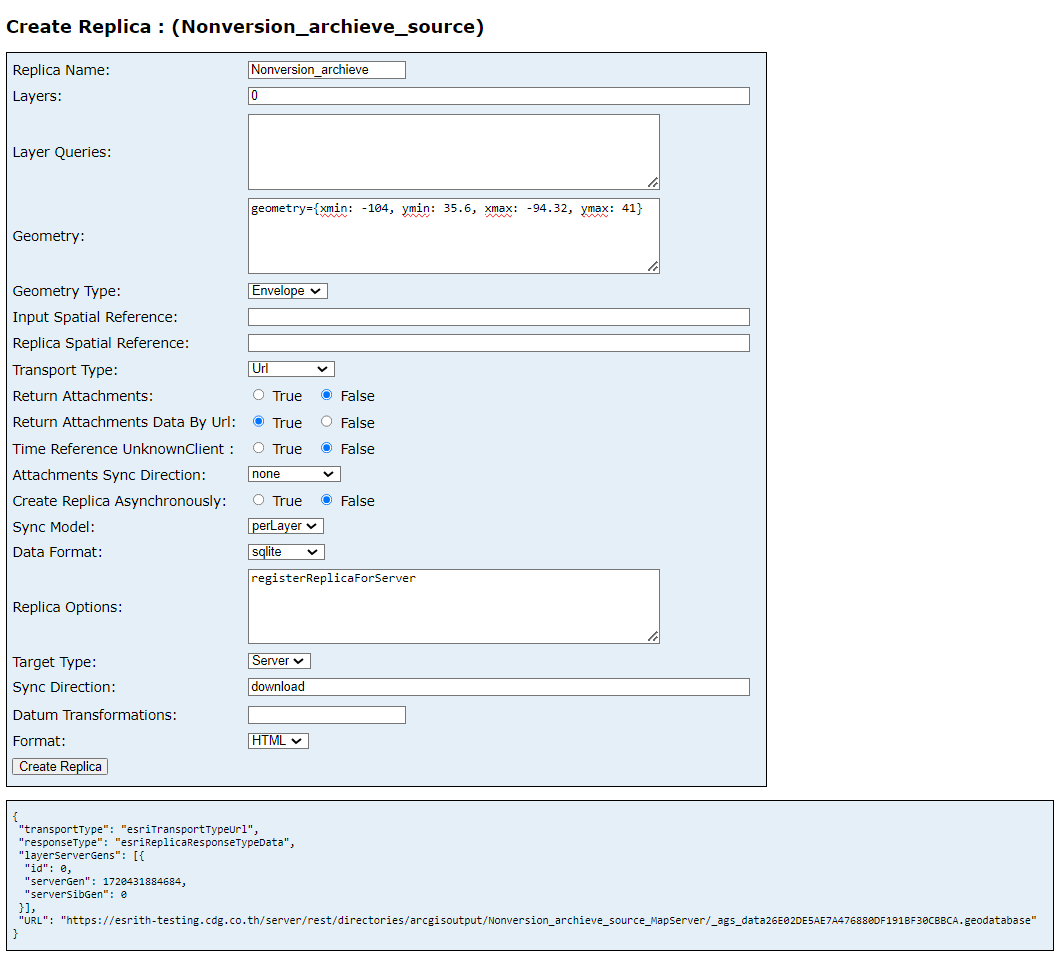

The config of create replica for my source service as below
The Replica with source ID is D97CA10C-E80C-4931-8627-51E27F6D7EE4

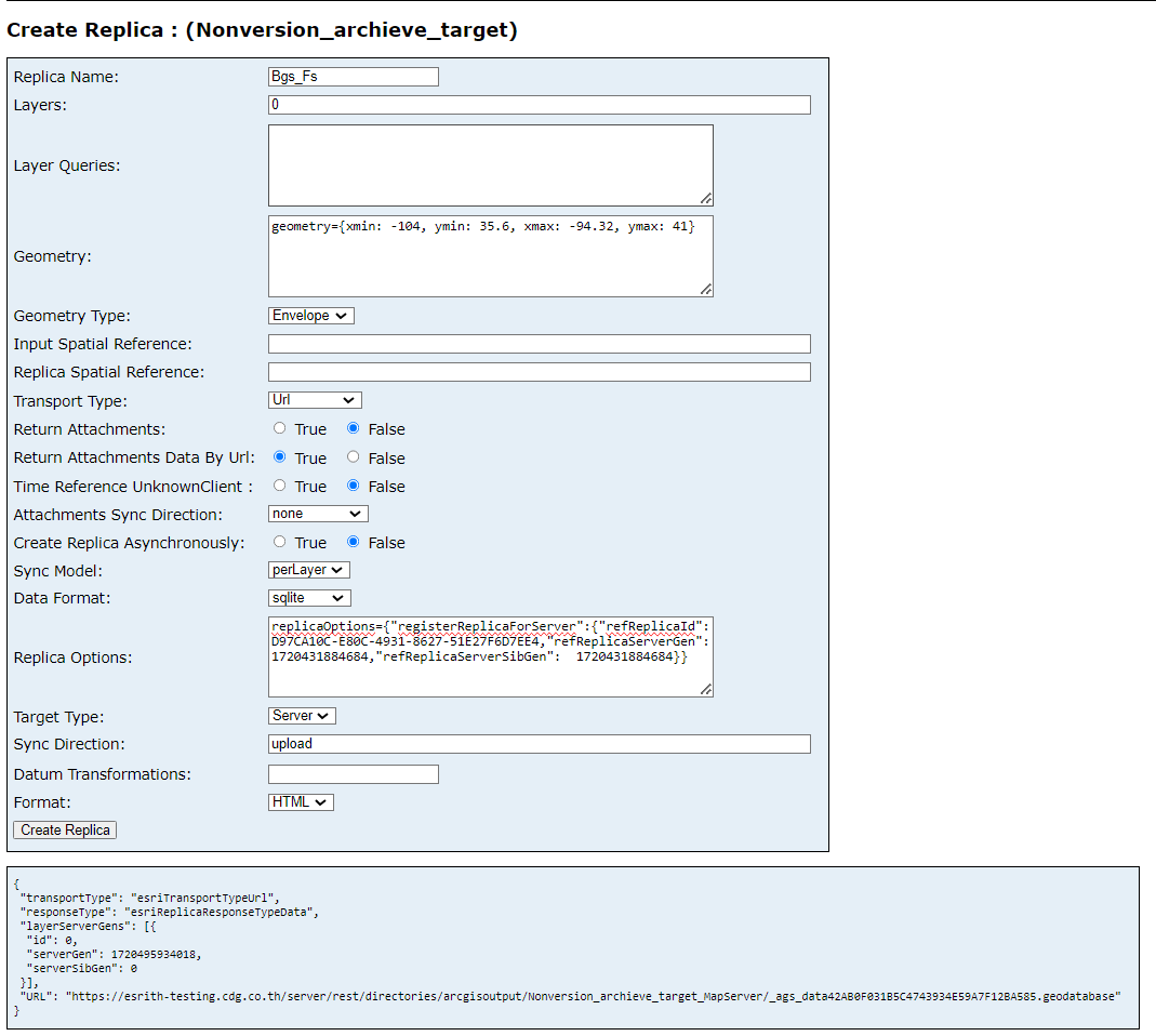

The config of create replica for target source service as below. which I put the Replica Source ID to target also

Hi @midmike,
The first thing I want to confirm is that the source and the target feature classes are stored in two different enterprise geodatabases. This is a necessary requirement for this workflow.
From the screenshots you provided there seem to be a couple issues with the functions syntax, that might cause the replica pair to be created.
  • For the source feature service, in the replicaOptions syntax, you need to specify the ServerGen and ServerSibGen numbers. Here is a syntax example: {"registerReplicaForServer":{"refReplicaServerGen": 1690749452000, "refReplicaServerSibGen":  1690749452000}}
You can use any online tool to generate the UNIX epoch time in milliseconds, then add the value for the ServerGen parameter.
  • For the target feature service, you correctly referenced the source replica ID, however there is an "=" sign that makes the replicaOtions syntax incorrect. Here is a syntax example: {"registerReplicaForServer":{"refReplicaId": "YOUR SOURCE REPLICA ID", "refReplicaServerGen": 1690749452000, "refReplicaServerSibGen":  1690749452000}}
A clear indicator that the operation was successful is that in the response, you will get a URL to a json file that stores all the replica information. Here is an example of a correct response: "https://.....esri.com/server/rest/directories/arcgisoutput/MapServer/_ags_fs24fff2cba933432d96a9bcdcdac16860.json"

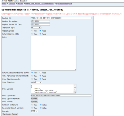

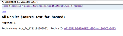

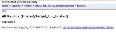

I complete the workflow The service from Reference feature service which source and target using the python script that you provided Feature service sync - Sample script is working 🙂
I saw your blog, the Reference feature service can be paired with Hosted Feature Service. However, I try to sync Replica with the python script.
It's error occurs when creating replica method of target Hosted feature service
So I do the create Replica by manually which same Replica ID for Source feature service (referenced). The Replica ID, finally MATCH and I put the Replica ID to file replicaID.txt
Source fs (reference)
Target fs (Hosted)
And Then I ran the script again try to Sync Replica but the error occurs,
And I try to manually Sync Replica but it's error also
