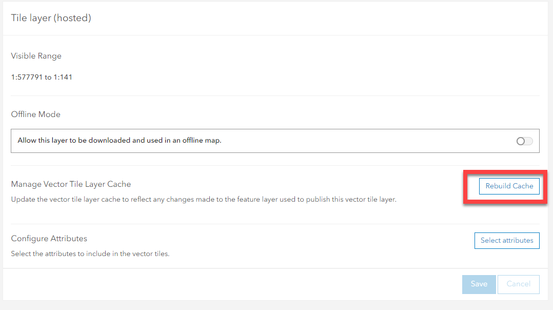

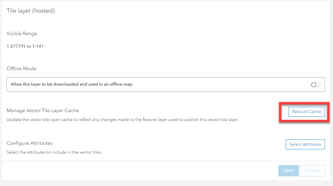

Our vector tile service has an associated, referenced feature service which allows the rebuild cache Rest operation:
Clicking on the "Rebuild Cache" button is working perfectly, therefore it looks like a great way to automate using this method.

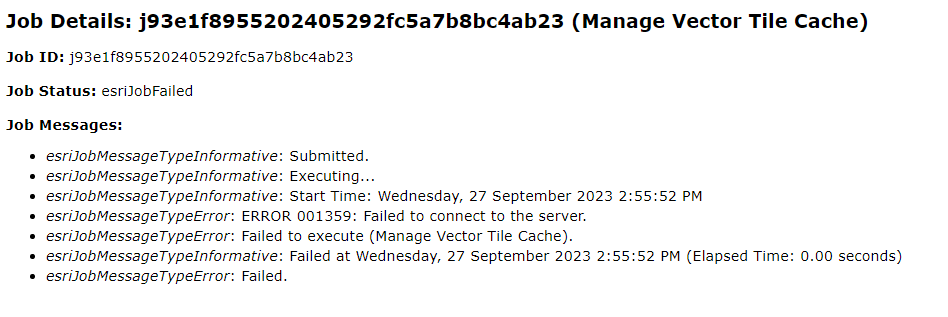

We have been unsuccessful so far and we are receiving this error response:

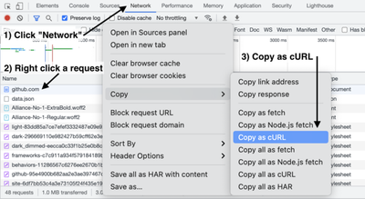

Have you tried using Postman to create the request for you? This image may help you get this in the right format 🙂
Postman can convert cURL requests to python - you then simply need to create a two-stage script.
getToken() (return Token)
rebuildCache(Token)

Thanks @A_Wyn_Jones it worked this way, very good outcome!
