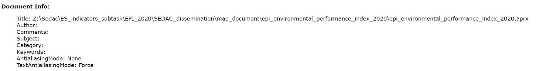

We're publishing map services to a new Enterprise deployment (10.8) and are having issues with the project (aprx) Document Info not being published. Instead, all that is displayed is the full path to the .aprx file in the Title field, everything else is blank (despite being populated in the .aprx). Any suggestions on a workaround? Is this perhaps a bug?

We resolved this with some help from Esri tech support. A Metadata style was not enabled on portal (oversight on our part). Once we enabled that, the document info is carried over from the .aprx to the service.
Greg
Sign into ArcGIS Portal  and navigate to Organization -> Settings -> Items -> Metadata-> Enable Metadata-> Enable  ISO19139 Metadata Implementation Specification.
