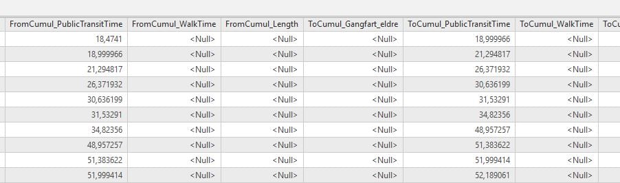

Im using the new transit tools in Arcgis Pro and it works well with my transit model. Service areas, routes, all works well. The same goes for the calculate accessibility tools, the time lapse and the rest. But I can't seem to get the walking distance part of the result. There are fields intended for this information in the output, but it gives me NULL-values, as this example from a service area lines output is showing:
Is there something wrong in my travel modes or cost attributes? I followed the tutorial on this part.

In order for the FromCumul_/ToCumul_ fields to be populated in your output table, I think you just need to set the Accumulate Attributes to accumulate the relevant cost attributes you care about.  If you want to see the accumulated WalkTime, you have to check on WalkTime in the Accumulate Attributes.  See the Accumulate Cost Attributes section in this documentation page: Service area analysis layer—ArcGIS Pro | ArcGIS Desktop
Regarding your second question: You cannot limit the overall walking time/distance.  You cannot make the solver force the traveler to stop walking after 5 minutes but allow them to continue riding for another 25 minutes.  Our solvers currently do not have this capability. However, using an accumulate attribute as described above, you can at least see what the overall walking time is.
