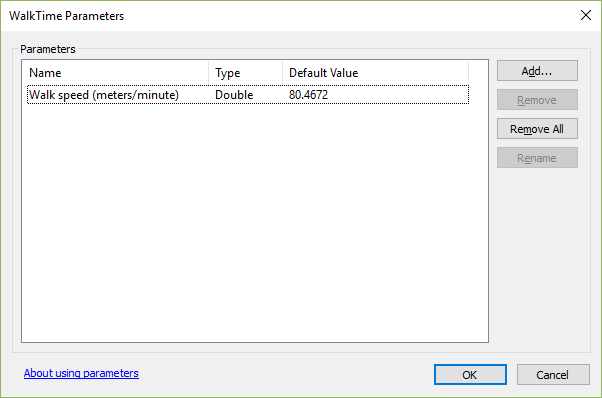

Here are some screenshots that may help with discovering what's going wrong with the Transit_TravelTime attribute service area:
Please let me know if this helps. Thank you!
DestinyKelley1
I think I should include the length information as well:
Should the value be shape_length instead?
MelindaMorang
Hmm.  All that looks correct, as it should be, since you built the network from the template anyway.  (Incidentally, Shape and shape_length basically do the same thing here, so it doesn't matter which you use.)
I looked at your Service Area screenshots again, and I noticed two things:
1) "Use time" is unchecked in your Service Area settings.  You need to turn the time of day on and set it to something specific or else the transit stuff won't be used at all.
2) Although your Service Area extends all the way to the edge of your network, the service area break value is like 5.6E-3, which is really tiny.  So there's definitely some kind of unit conversion issue happening.  Since you used the template, it ought to be working, but maybe there's something wrong with the template.
