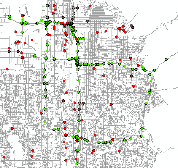

Just downloaded the latest version.  I like the Intersections Error tool. In my case, many errors are not really errors, but freeway overpasses and underpasses.  Tim and I chatted on the phone and one idea I had was to be able to rebuild just the visable portion of the scratch topology, just so I can keep track of what I've fixed.
However, since Tim is gracious enough to provide the errors as a point feature class there really  a need to over complicate things.  With the IntersetErrors point feature class, I symbolize them based on the Exception attribute.  As I work on the my streets, I simply calc Exception = 1 as I fix the error and move on.  I can also select those error points that spatially fall on a freeway and do the same calculation....
ETA: Below you can see the basic outline of the freeways in the Salt lake Valley:
Tim Witt
That should just about do it....
