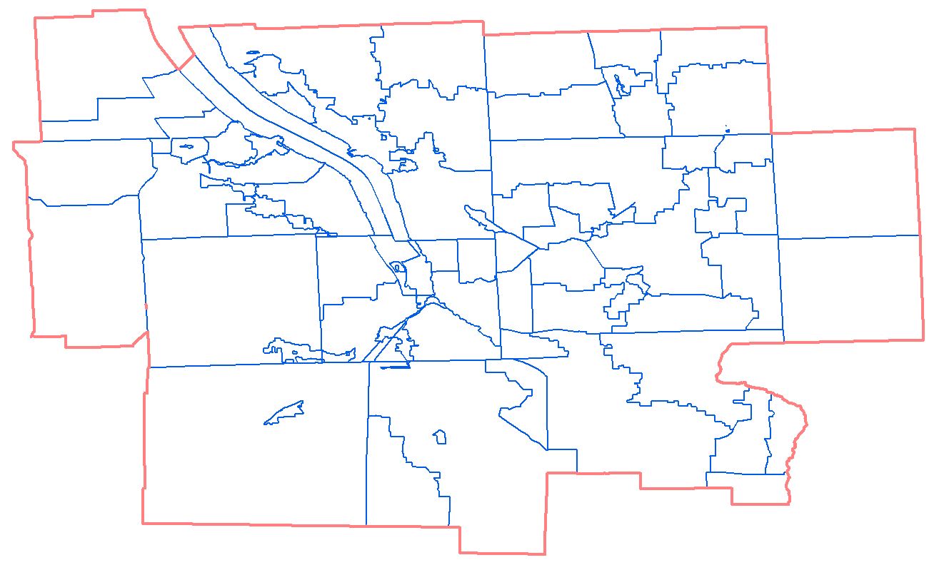

Is there a users guide for this somewhere? I'm trying to figure out why the tool is giving me gaps around the borders of my district layers...Gap error around the edges of the Fire districts
JoeBorgione
MVP Emeritus
There is always a 'gap' to the outside of a polygon feature class when you create a topology.  Literally, that's what it is, although it's pretty pointless at the same time....
That should just about do it....
CattyannCampbell
Hah and I thought I had too much caffeine or something.
