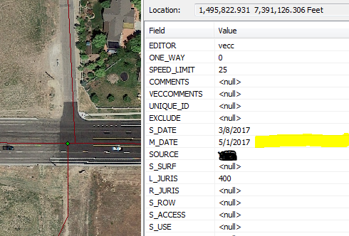

JoeBorgione
MVP Emeritus
That's cool Tim;  just tried it.  Before running the tool I created the dangle that was subsequently found.  It's the only one in the YourDangleErrors point feature class:
This is great feature for me; I can run it just on streets that are newly added and get them fixed asap.  Thanks!
ETA:  here is a perfect example.  Notice the M_DATE value (modified date) of the street that has the dangle...
