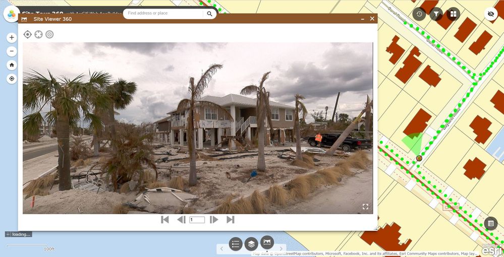

Another option is to use the 360° photo and video Experience Builder widgets that can be found in the Esri Marketplace:
