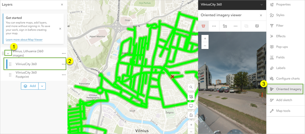

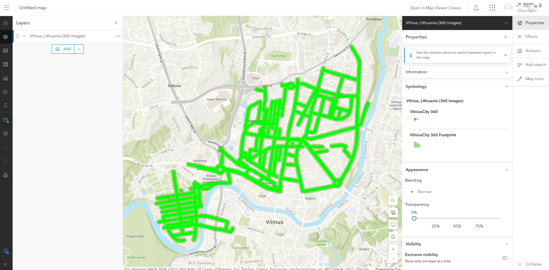

As an aside, can anyone get this gallery items (https://www.arcgis.com/home/group.html?id=456b8d7d8f8f4e45932ec20ddda8ab67#overview) to work? When I open "Vilnius, Lithuania (360 images)" in Map Viewer on ArcGIS Online, I dont see the option to use the Oriented Imagery tool on the right? Am I missing some license to use it?

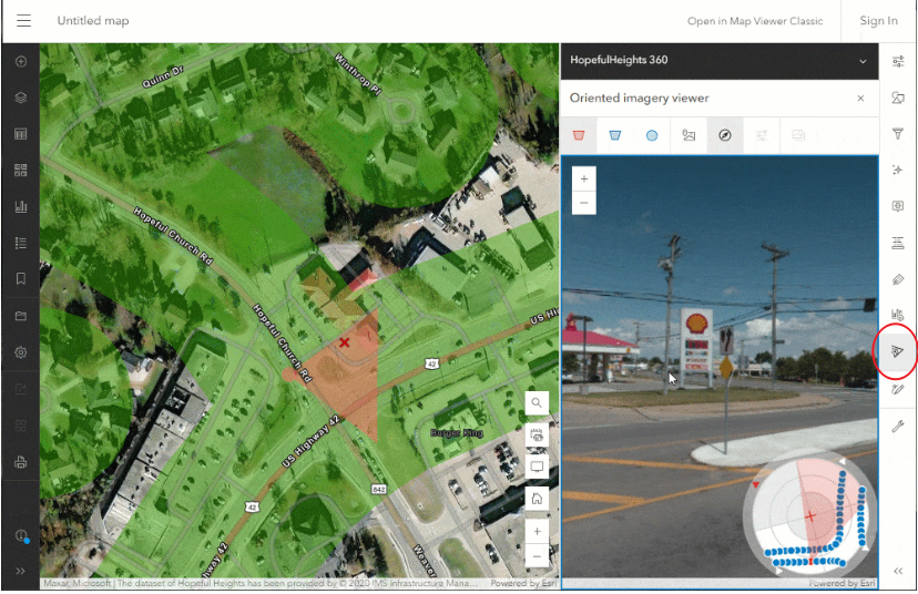

My understanding is that I should be able to see it on the right toolbar, similar to below.

@blahboot, in the Map Viewer, expand the Vilnius, Lithuania (360 images) group layer on the left and select the VilniusCity 360 layer. Then, the Oriented Imagery button will appear.
What type of images do you have that you want to work with? Do they have XY coordinates as well as a directional heading? Most cell phones capture this information now-a-days; drones too!
