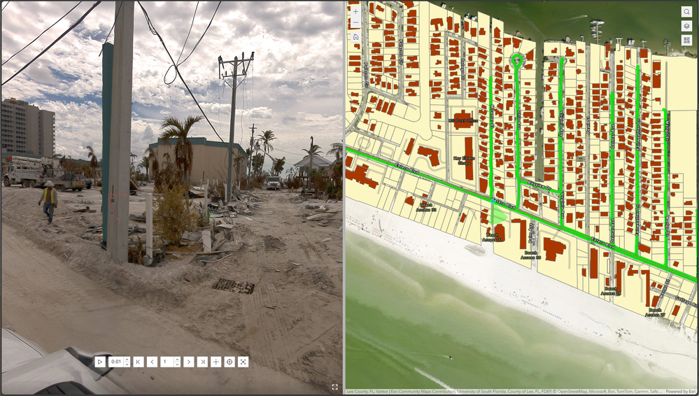

Chinmay, one approach you might want to consider is using tools like Vidgeo and Site Viewer 360 alongside (or in place of) the standard OI Viewer, depending on your workflow. These are designed for large-scale 360° video and imagery in ArcGIS and can reduce the need to manage massive collections of discrete panoramas.
For example:
  • With Vidgeo, you can stream 360° video and dynamically derive viewpoints rather than managing hundreds of thousands (or millions) of individual images. More info is available here: https://www.nodeology.net/vidgeo/
  • Site Viewer 360 is optimized for navigating large volumes of 360° content and helps keep the user experience responsive at scale. More info is available here: https://www.nodeology.net/site-viewer-360/
Both approaches can leverage AWS S3 for storage, while enabling a more efficient, streaming-based architecture.Screenshot 2025-11-09 095358.pngScreenshot 2025-11-09 095358.png
