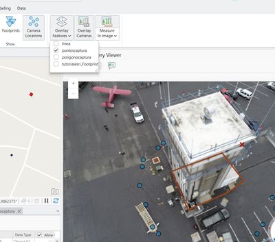

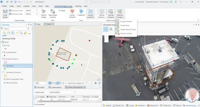

I am using the data from the oriented images tutorial:
- Download the images
- Create the oriented images layer
- Add the necessary fields to take measurements, such as OrientationAccuracy
- The options for measuring on the image have been activated and I can use them
- Create point, line, and polygon layers within the geodatabase where the oriented image layer is located. Use the same coordinate system as the oriented image layer.
- Add the following fields to these layers: ImageGeometry (Blod), ImgUrn (text), OIObjectID (BigInteger), SequenceOrder (text).

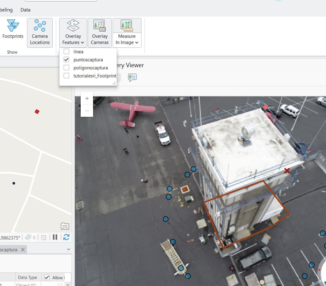

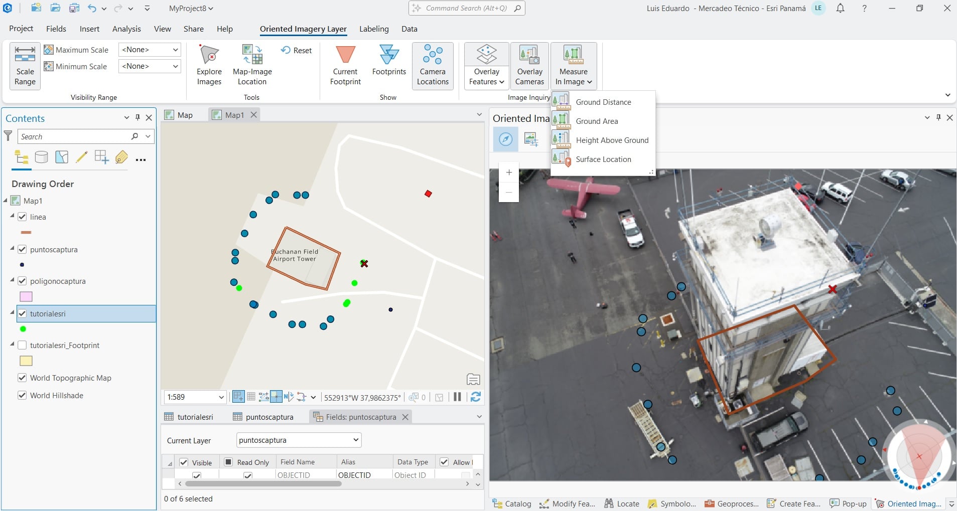

But when I select the overlay layers, the Edit option does not appear and therefore the capture options are not activated.
I can digitize on the map and overlay those layers on the oriented image, but I cannot use the capture options.
What can I do to activate them?
What configuration might I be missing?

After updating ArcGIS Pro to version 3.6, the capture now works, but it does not work well. The geometries are not located correctly, even though the Image to Map tool locates them correctly.
