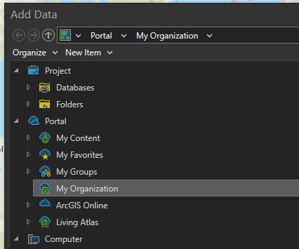

The oriented imagery add-in shows in the add-in manager but when I click 'add data' in a new project no sign of 'Add oriented Imagery'.

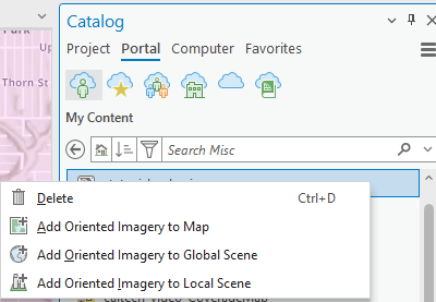

There is a new version of the Addin in the works as there was a change in the Add Data menu. The current addin will not work the way the tutorial intended. However is you have published an Oriented Imagery catalog, you can browse to that catalog in the catalog window, right click on your published catalog and add it to the current view.
You will see your catalogs in My content in Portal, not My organization unless it is shared to the Organization.

Thanks @RandallRebello for your reply.
I must have done something wrong as all I can see is a hosted vector tile layer and a vector tile package in my Catalog when working in Pro.
When going online I can see the OIC which is shared to my organization as are the tile layers:
but no way to access it from Pro ...
I'll try again and see.
Have a nice day!
Bert
