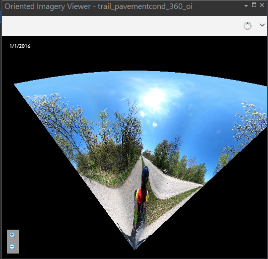

Hi Im having issues with displaying 360 images as a sphere. Ive kept the default values when importing the imagery. But somehow the field of view does not form a sphere around the capture point. Its possible that the Exif information doesnt have the correct information to display the image, but from what I see based on tutorials it seems to have what it needs. Ive attached a screenshot with an example image, properties for the points, as well as the properties for the oriented image catalog.

Heres a quick view of what I mean when I say that the images are not showing up as a sphere/bubble .
The attached image shows a bit more information.

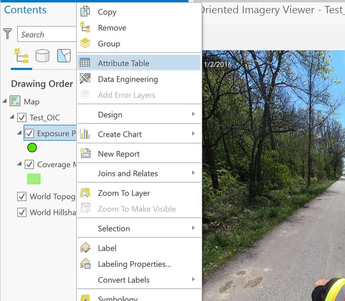

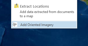

Load the OIC using the Add Oriented Imagery Catalog dialog. You can bring it up by clicking here..
On the Add Oriented Imagery Dialog click here..
This will bring a File browser. Navigate and pick the OIC you want to load back into the view.

I tried what you are suggesting, unfortunately it crashed Pro. But before it did I was able to see the images and they are still showing up as this "wedge" shape.
And just to clear up a few details:
- the HFOV & VFOV were 360 & 180 when initially created.
- I do actually have the catalog published to our portal and have tested it on webappbuilder and the resulting view of the images are the same, the "wedge" shape shown in my OP image attachment.
