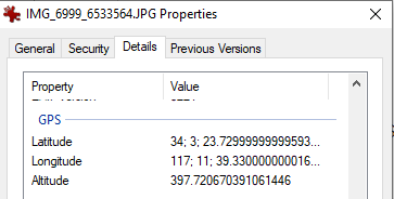

Thank you for that information! I was just using the default data provided by the tutorial, which is a text file with a list of links such as:
http://orientedimagerysamples.s3.amazonaws.com/EsriCampus180701/109/IMG_7706_4983491.JPG
It does appear that the images have GPS data associated. There is also another error that might be the issue which says "Unable to read VersionJSON".  I might try to find another sample of oriented images to test as well.

Please see log attached. I am also able to see the pictures and see the downloaded image attached.
