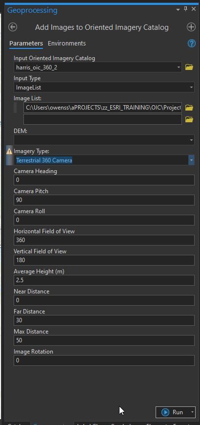

Having massive issues loading images to OIC using the "ImageList" utilizing the Amazon S3 Cloud Storage for 360 degrtee Imagery assets.
Parameters:
Error Messages:
Dead in the water here - any ideas??
Thank you.

Hi Owen,
Its unfortunate you are facing this issue. Can you check a couple of things..
1. Check if all the items in the list are accessible.
2. If all the items list are correct. ie make sure there are no items in the list that are not images.
3. If you have the images in a folder on your computer try adding the images by specifying the folder.
4. The image list should only contain the list of images. It should not have a header or should not be comma delimited. Each image path should be in a single line.
5. The image list should be a text file.
If you still face an issue with this please send me the list in a private message and I can have a look for you.
Also sometimes there could be more info in the logs folder in the oriented imagery GP Tools folder.
Thanks,
Randall

After reviewing your QC checks, all seems to be correct. See attached Image List.
RandallRebello
HI,
Thank you for the file. Everything looks fine. Can you also check the documentation  ( c:\Image_Mgmt_Workflows\OrientedImagery\Documentation\OrientedImageryCatalogManagement_UserGuide.pdf ) for the expected S3 bucket settings.  See the chapter : Appendix C: AWS Bucket settings for Oriented Imagery.
This will basically ensure that the GPTool has access to the bucket. Its possible that the GPTool did not have access to the files and failed. Since it runs in multi processing mode it failed and crashed one of the processes.
BTW are you and OwenS the same person?  Just checking.. 🙂
Randall
