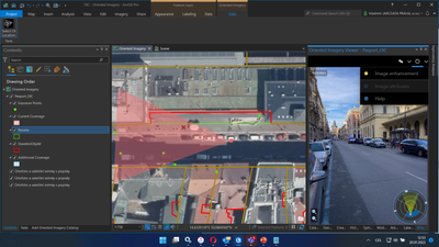

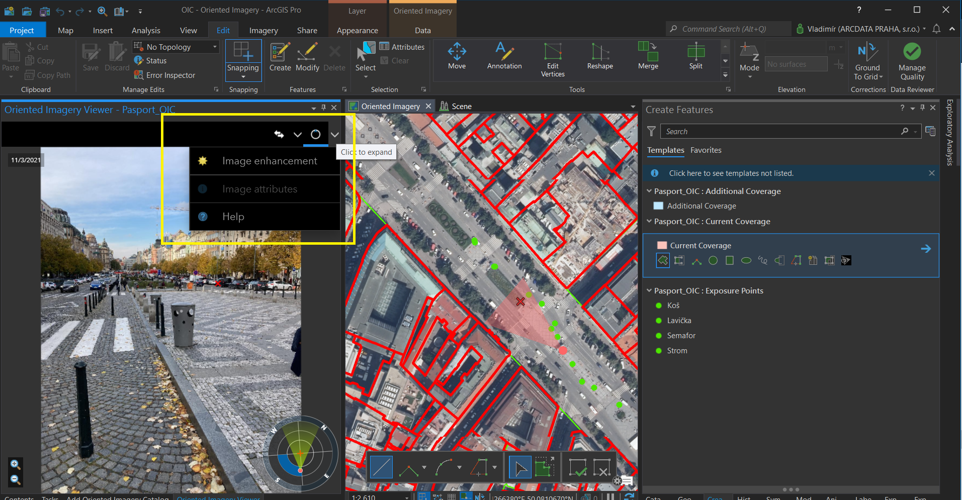

Hello,
I am using ArcGIS Pro 2.9 with last version of OIC plugin, but I don´t see there an Overlay tool in the menu (the menu is different against menu shown in OIC Storymap).
Have you removed this tool in this version, or it must be enabled somewhere else?
Thank you,
Vladimir

Hi @RandallRebello,
thank you for tip, but it hasn´t helped. Neither re-open OIC image nor ArcGIS Pro restart. Still I don´t see Overlays tool there, neither for observation points nor for difeerent layers like "parcela" even everything is in the OIC group.
Vladimir
