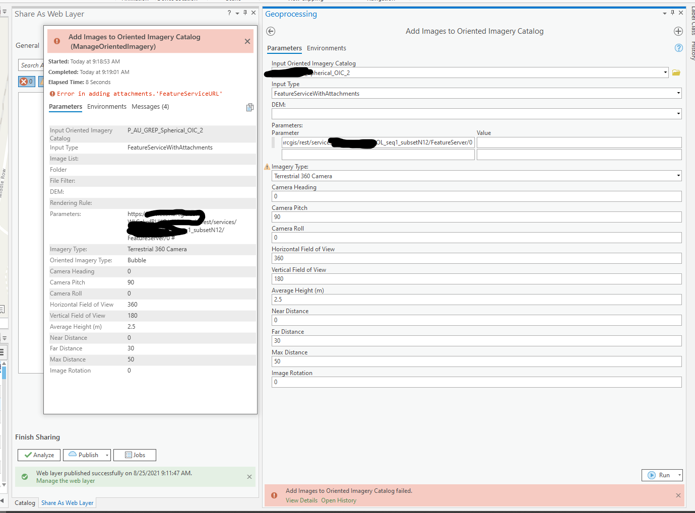

In lieu of using an AWS bucket (because: security ICT), I was attempting to load some sample images with the ManageOrientedImagery.pyt using the input type = FeatureServiceWithAttachments.
I get this error : Error in adding attachments.'FeatureServiceURL'.
From Log XML: <text>Error in adding attachments.'FeatureServiceURL'</text>
I have tried these in the Parameter dialog.
https://thzzzcom.au/arcgis/rest/services/Hosted/zzN12/FeatureServer
https://thzzzcom.au/arcgis/rest/services/Hosted/zzN12/FeatureServer/0
https://thzzz.com.au/arcgis/home/item.html?id=4afezzz...
also tried from AGOL not portal, also tried public not secured
Capabilities: Create,Editing,Uploads,Query,Update,Delete,Extract. & attachments enabled,
Anyone else successfully loaded images in this way?

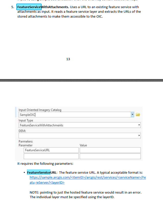

Note - I can load these in using the Image List option OK & nothing extra in OrientedImageryCatalogManagement_UserGuide.pdf from here that I can see either.
