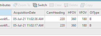

Can you make the following changes to the HFOV and VFOV in your attribute table.
That should fix your issue.  Do let me know if you still have a problem.
I think the problem is that you have bubble imagery and the HFOV and VFOV values expected were 360 and 180.

FatimaZahra_Mokhtari
Hi Randall,
It worked. Thank you so much. I didn't notice that the values of HFOV and VFOV were differents in the attribute table.
