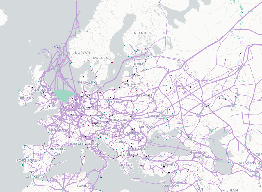

Hi,
I have made a leaflet web application (https://alsi.gie.eu/data-visualisation/maps), next I wish to add layers on top which are hosted on https://services.arcgis.com/W1S2EV01pfLNmn8R/arcgis/rest/services/network1908/FeatureServer.
I have tried using the layers directly hosted on the featureserver, but found this too be very data intensive. Whenever I zoomed in, the entire application crashed; because of the redrawing. I have added it as such:
L.esri.featureLayer({
url: 'https://services.arcgis.com/W1S2EV01pfLNmn8R/arcgis/rest/services/network1908/FeatureServer/9',
style: function () {
return { color: "#c29ed7", weight: 0.5, opacity: 0.5, stroke: true, fill: false };
}).addTo(map);
I then came across similar issues on https://github.com/Esri/esri-leaflet/issues/738. I figured that I would need to either convert the FeatureServer to MapServer or find another solution that basically projects an image instead of the entire shapefile onto the leaflet map. Can anybody point me in the right direction here? It would be really helpful if you explain the steps, as I'm not very proficient in ARCGIS/ESRI.

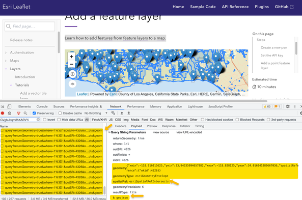

There are multiple optimizations been done behind the scenes. @JeremyBartley explained some of them on Behind the scenes, What the JS API and ArcGIS do for you.
But in summary ArcGIS API for JS use WebGL (Leaflet doesn't) plus the ArcGIS API for JS make use of all the optimizations included in the Feature Service to reduce the data transferred and produce faster responses (tile caching, PBFs encoded responses, geometry quantization, etc.) <- and as far as I know, the Esri Leaflet FeatureLayer.js doesn't as can be seen here:
There you can see how Esri Leaflet request a GeoJSON from the service, plus every time you zoom in & zoom out send a bunch of requests to retrieve only the geometries needed (but do not cache, compress or simplify them) <- it would be great if someone in the community would open a PR to help improve it (but I think there are pretty complex optimizations in the JSAPI that wouldn't be easy to replicate).

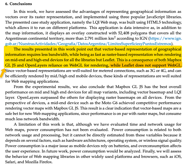

Hi @DanielDormont  I just read "Evaluating the Performance of Three Popular Web Mapping Libraries: A Case Study Using Argentina’s Li..." (compares Leaflet, Mapbox GL JS and OpenLayers) and remembered me this thread:
...And leaflet does work with WebGL, via esri-leaflet-vector, doesn't it? In fact that's something I've been wondering. Since we already use esri-leaflet-vector to show vector basemaps, is there not a way to use that same technology with feature layers?
Spoiler of the conclusions 😜:
I will see if I can do my own research and include the ArcGIS API for JS too to the equation 😉, it would be nice to have a rigorous analysis considering them all and different visualization types.
