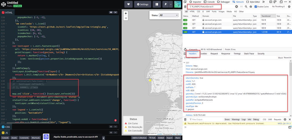

  • I changed your 1min interval to a map click handler to call refresh() on the layer, just for my convenience.

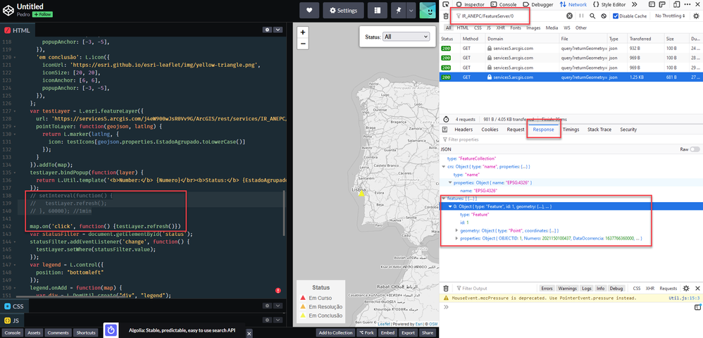

  • In the developer network tools for your feature service layer, we are checking and comparing the GET request headers to see what parameters were sent to the query endpoint. In this case, for a single refresh(), 4 unique requests were sent (using automated "tiling" logic).
  • In the developer network tools for your feature service layer, we are checking and comparing the GET response headers to see what the feature service layer is returning. In one of the 4 responses, I routinely see 1 feature come back.

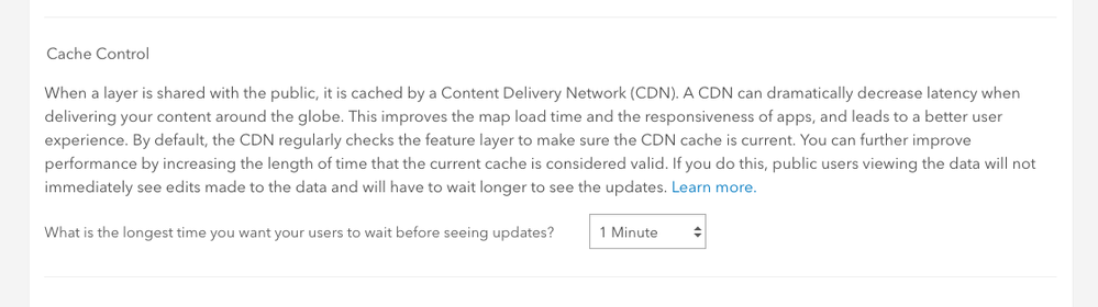

Are you able to check the "Cache Control" setting of your FeatureServer in ArcGIS Online? I'm curious if this is playing any part in the mismatched state we see in the map sometimes.

Thanks again for your help! I'm not the owner of the service, but if I understand the documentation of this feature (https://doc.arcgis.com/en/arcgis-online/manage-data/control-cache.htm), the cache time is managed by the server. Reading this quote:
If you stop sharing the layer with the public, cached responses temporarily remain on the CDN until the cache expires. This means if the maximum cache age is set to 5 minutes, it can take up to 5 minutes before the layer is inaccessible to the public. People signed in to the organization see the latest data, however.
I believe that if the layer was cached, it would also not be updated when refreshing the browser. So, it would wait, for instance, 5 minutes to update for every public clients, being the server controlling the 5 minutes and not the clients. I'm I right? Because here the layer is in fact updated, but the refresh() method seems to not bring the updated features to the map.
