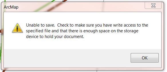

The add-in is installed on my local C drive. Immediately following the upgrade and this issue I also started having issues saving my mxd. I'm wondering if these errors are related. Any thoughts?
