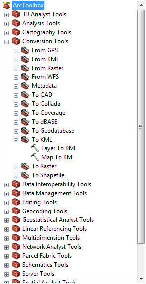

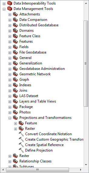

If your shapefiles or feature classes have an unknown coordinate system one could try the below workflow.
Find the coordinate system used to make the original data. Open the ArcMap doc where the shapes are displaying correctly. Then open the data frame proprieties. Then go to the coordinate system tab.
Note the system in the Current coordinate system field.
Now use define projection to set the system in the problem data sets.
Then export to KML most likely with Layer to KML
Hope this helps
