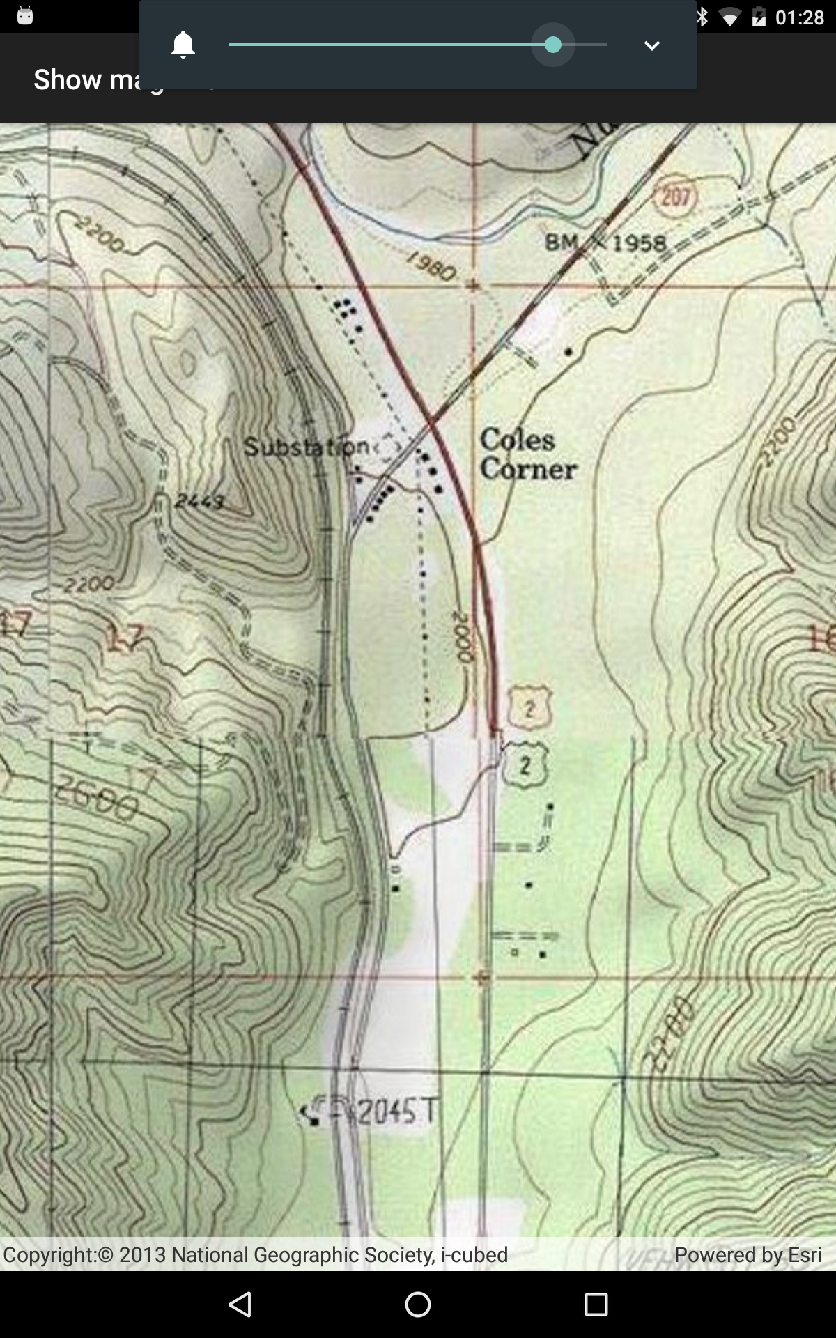

This is what the map looks like at 15
At 15
Here is what the map looks like at 19. Doesn't look different, does it? That's because it didn't let us zoom that far.

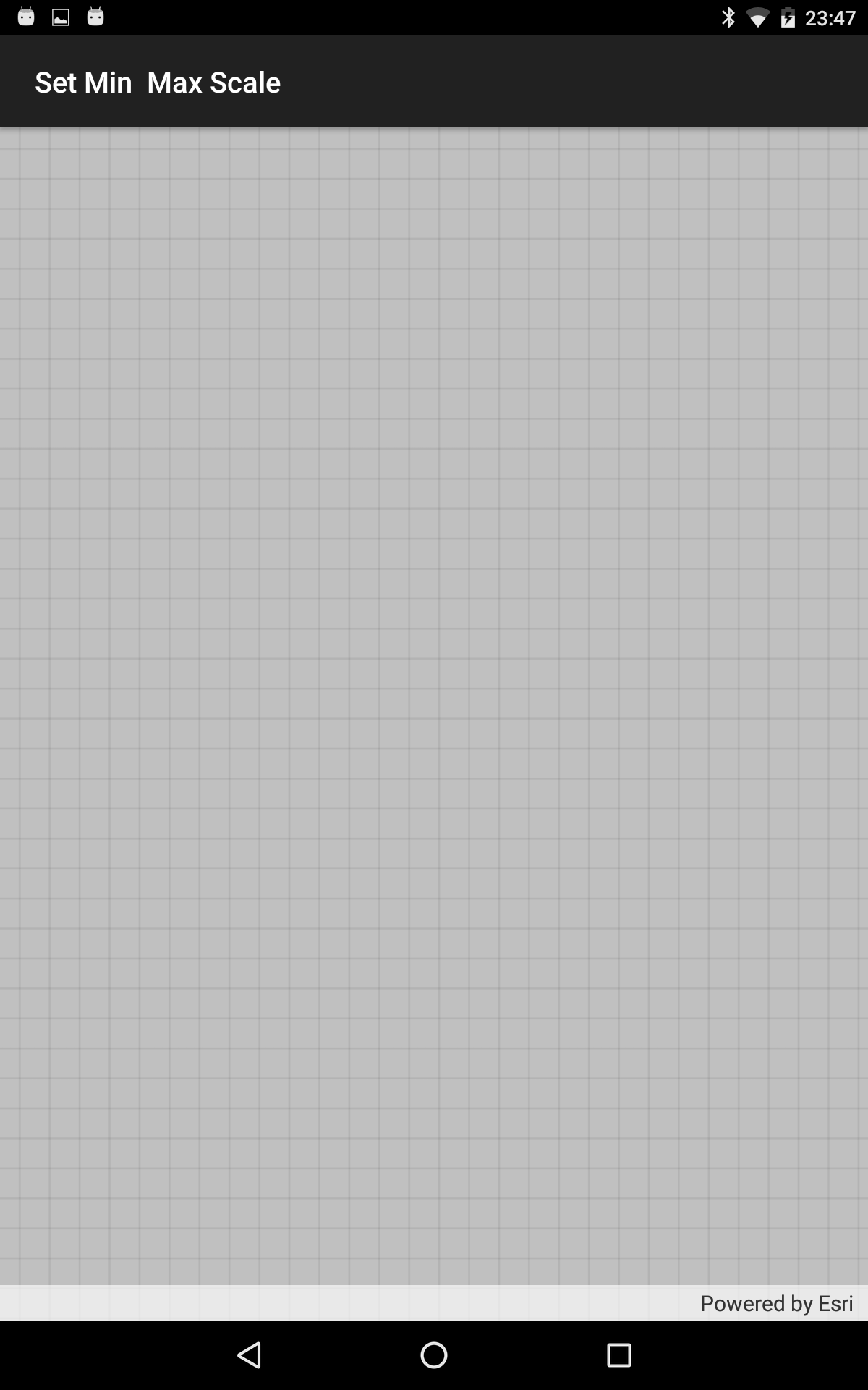

Then we run across the example of the min and max scale.
We thought we'd be smart and set min=1 and max=400000.
Now we can zoom in. And see nothing.
Zooming in to 19.
