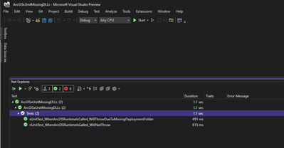

I created this sample project. It demonstrates how the xUnit test fails while the nUnit test does not with the same configuration. Note that the project configuration needs to be manually set from AnyCPU to x64 in visual studio.
