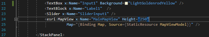

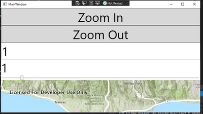

My mouse wheel event not firing in my WPF app. What am I missing?

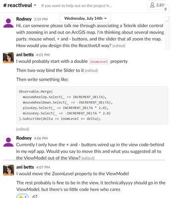

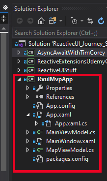

I'm trying to use ReactiveUI to synchronize a slider control, zoom in and out buttons, and the mouse wheel to control zooming on ArcGIS map.
I'm still in design phase...When I use the mouse wheel to zoom, I need the slider to auto update it's position relative to current zoom. I'm thinking in the mouse wheel event to set the slider somehow. I really don't know at this point how I'm going to coordinate all of these things with ReactiveUI. Any ideas are welcomed.
Here is my github that shows a map with a slider and zoom buttons but they are all still independent of each other. ReactiveUI can easily make this happen but I'm not really understanding ReactiveUI that well.

The mouse wheel event doesn't fire, because the mapview reacts on it. This is pretty typical for routed events in WPF. You can use the Preview* events instead, or choose to subscribe to events regardless of bubbling behavior. However from your scenario, as Mike is saying, use the info from the mapview instead to sync your slider - I'd recommend using the MapScale property to set your slider. You'll probably want to use a Log value of the scale though, since one "notch" on the slider, should double the scale value.
