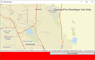

Hi @HamishDuff , thank you for answering. Basically, I'm unable to display the shapefile when I use Local Server and ShapeFileWorkspace though I was able to display it using ShapefileFeatureTable . Here's an screenshot of my test app after selecting the subdivision.shp file. I actually copied the code from the DynamicWOrkspaceShapeFile sample. I'm also wondering why this sample was removed from the main branch of the git repo.
