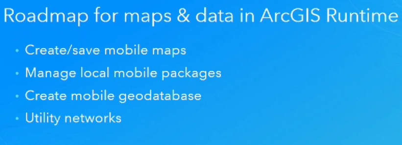

I was watching the 2018 Dev Summit video ...
ArcGIS Runtime: Migrating from ArcGIS Engine - YouTube
At 33:40 Mike(?) says "we'll support creating geodatabase from scratch".
Does this mean I'll be able to create a mobile (sqlite) geodatabase without having to to use ArcGIS Server?
Any updates on when this capability will be included?
Thanks, Kirk
Tags (1)
MichaelBranscomb
Esri Frequent Contributor
Hi,
Yes, I was referring to an enhancement to the API to allow the creation of new mobile geodatabases with tables, fields, etc and edit features/records in those tables.
This is still on the roadmap, but is currently not scheduled for a specific release.
