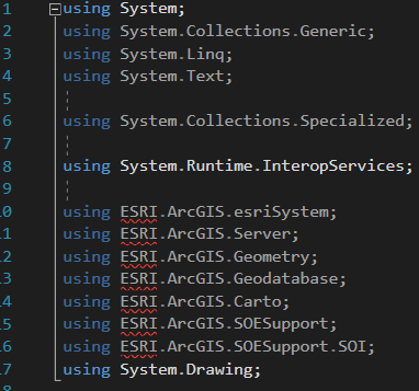

I'm trying to use the Server Apply Watermark example from the community samples to create an SOI that will be used to somehow watermark a depricated map or feature service. I haven't gotten too far though, as I can't even get the SDK to install to my project, which is what I suspect is causing the following reference errors:

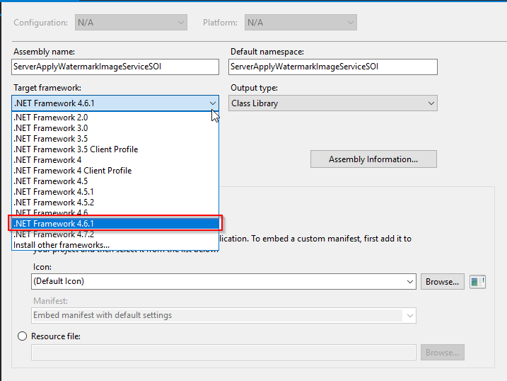

3. I need to point my project in Visual Studio to whatever the most current supported version of the .Net framework is and as indicated in the following, that version is 4.6.1:

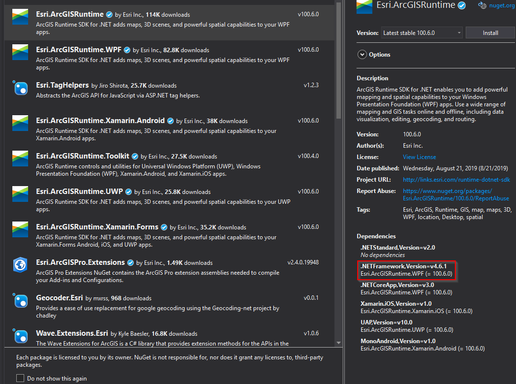

So I've done all of the above but when I go to install the SDK, I see the following prompts:
Attempting to gather dependency information for package 'Esri.ArcGISRuntime.100.6.0' with respect to project 'ServerApplyWatermarkImageServiceSOI', targeting '.NETFramework,Version=v4.6.1'
Gathering dependency information took 80.16 ms
Attempting to resolve dependencies for package 'Esri.ArcGISRuntime.100.6.0' with DependencyBehavior 'Lowest'
Resolving dependency information took 0 ms
Resolving actions to install package 'Esri.ArcGISRuntime.100.6.0'
Resolved actions to install package 'Esri.ArcGISRuntime.100.6.0'
Adding package 'Esri.ArcGISRuntime.WPF.100.6.0' to folder 'C:\ServerApplyWatermarkImageServiceSOI\packages'
Added package 'Esri.ArcGISRuntime.WPF.100.6.0' to folder 'C:\ServerApplyWatermarkImageServiceSOI\packages'
Added package 'Esri.ArcGISRuntime.WPF.100.6.0' to 'packages.config'
Successfully installed 'Esri.ArcGISRuntime.WPF 100.6.0' to ServerApplyWatermarkImageServiceSOI
Adding package 'Esri.ArcGISRuntime.100.6.0' to folder 'C:\ServerApplyWatermarkImageServiceSOI\packages'
Added package 'Esri.ArcGISRuntime.100.6.0' to folder 'C:\ServerApplyWatermarkImageServiceSOI\packages'
Added package 'Esri.ArcGISRuntime.100.6.0' to 'packages.config'
Successfully installed 'Esri.ArcGISRuntime 100.6.0' to ServerApplyWatermarkImageServiceSOI
Executing nuget actions took 2.3 sec
Time Elapsed: 00:00:02.8359139
========== Finished ==========

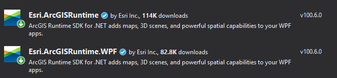

Great! That went smooth, and look! My project doesn't just have the Esri.ArcGISRuntime package installed, but also the ArcGISRuntime.WPF package installed.
This should work, right?

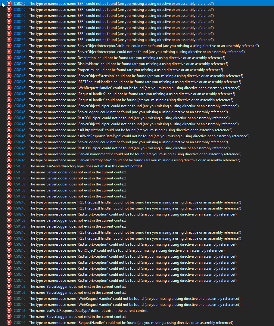

Wrong. The reference errors are still showing and I have a big list of errors complaining about missing assembly references.
Any idea what I'm doing wrong? There isn't a whole lot of setup documentation in the repo and I'm kind of at an impasse.

BrianVan_Nostrand
All,
My colleague Jeff showed me that the issue seems to be that once the SDK is installed, Visual Studio looks for a "specific version" by default. Turning this option to False has updated my references and those errors disappear. I truly hate programming sometimes.

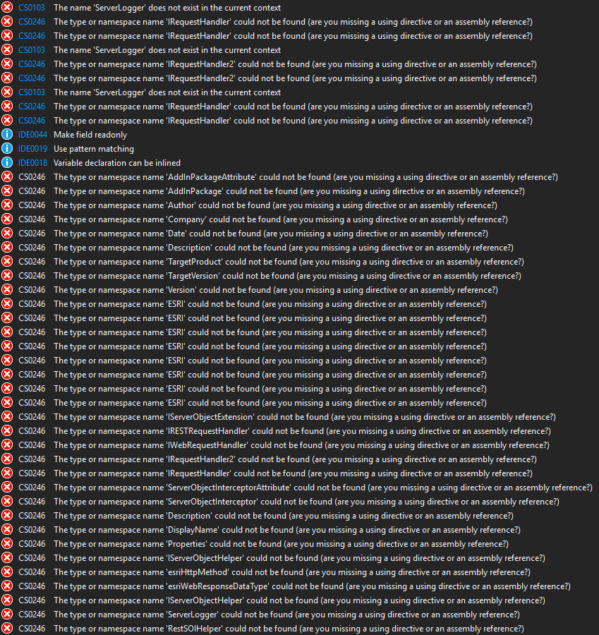

Hanhan Sun below has indicated that I should be using the ArcObjects SDK to use this project. I've installed the ArcObjects SDK for my version of ArcGIS, 10.7.1, but when I open the solution in visual studio, I'm still getting the reference errors I outlined above. Any idea how to get rid of those? Is there something in Visual Studio that I'm missing?
Thanks,
Brian

   I've installed the ArcObjects SDK for my version of ArcGIS, 10.7.1, but when I open the solution for the Server Apply Watermark example in visual studio, I'm still getting the reference errors I outlined above. Any idea how to get rid of those? Is there something in Visual Studio that I'm missing?
Thanks,
Brian
