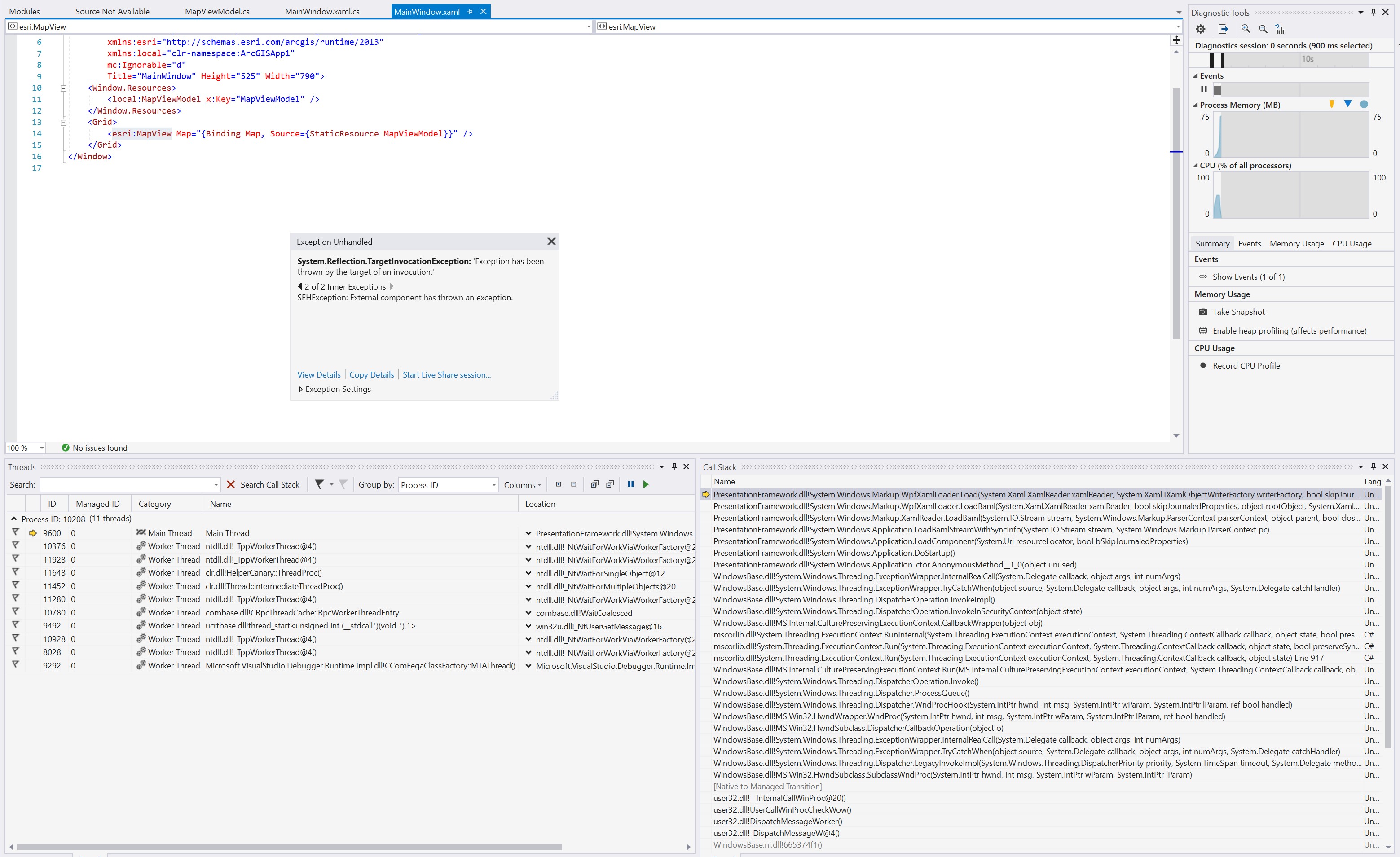

I cannot create/run any of the templates for ArcGIS Runtime SDK .NET in Visual Studio Community 2019.  They throw exception errors.  This is the out-of-the-box apps that are created in a new solution/project.  I then loaded the ArcGIS Runtime SDK for .NET (WPF) from the Microsoft Store to see if I could get a sample to test.  That also throws exception errors.  Here's an example:

I am not running any anti-virus other than Windows Security.  Turning off all Windows Security didn't fix it.  ESRI Support tech had me downsize my screen resolution on 4k monitor and that didn't change anything either.  He seems to think this is related to display/monitors since this happens when the mapview is called from a template app.

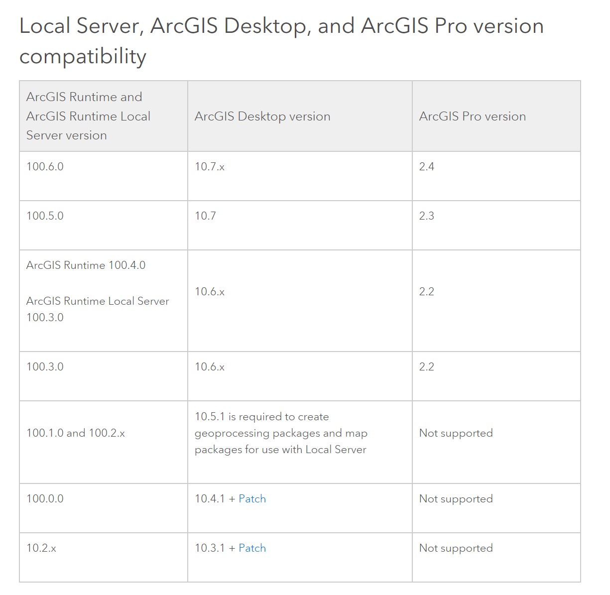

I had installed v10.7.1 to align with this compatibility grid, to make sure that was not causing any problems with Runtime:
It feels like there some systemic issue with the latest versions of your software and my desktop computer.
Today I downgraded to v10.6.1 of ArcMap/Catalog and v100.5.0 of ArcGIS Runtime and everything is working fine.  ***Except the ArcGIS Runtime SDK for .NET (WPF) Windows app which runs on v100.6.0.  That still throws the same errors.
