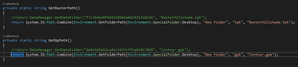

Mike I am just trying to reuse https://github.com/Esri/arcgis-runtime-samples-dotnet/tree/master/src/WPF/ArcGISRuntime.WPF.Viewer/S... and make it an independent WPF tool rather than a user control. I am using same codes and same data (I am accessing the same data from a different location) as in picture below

Hi,
You may need to set the TempPath property to a shorter path (by default it uses your user profile temp).
ArcGISRuntimeEnvironment.TempPath Property
e.g. to verify if this is the case here try something like "C:\Temp".
