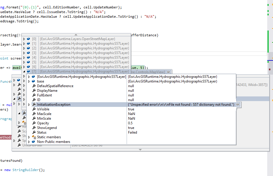

I have successfully used the ArcGis Runtime SDK to develop a mapping application for WPF in the past. I am now trying to make this work for a Windows Store application, but the S-57 ENC cells are simply not showing.
During debugging I can see that the initialization of the HydrographicS57Layer fails with the exception "Unspecified error. File not found : S57 dictionary not found."
This error happens inside the ArcGisRuntime dll.
I have created a ArcGis runtime deployment manifest including the Hydrographic (S57) symbology.
The problem occurs regardless whether I debug the application in Visual Studio or build a app package and deploy through Powershell script.
I have attached a screenshot from Visual Studio showing the error.

Have you attached Runtime deployment for S57 to your application? Read more from Create an ArcGIS Runtime deployment—ArcGIS Runtime SDK for .NET | ArcGIS for Developers

Yes, as you see in my post "I have created a ArcGis runtime deployment manifest including the Hydrographic (S57) symbology."

Can you verify that you can find deployment folder under the application deployment. You can also try to define symbol path explicitly before initializing ArcGISRuntimeEnviroment.
ArcGISRuntimeEnvironment.SymbolsPath = @"arcgisruntime10.2.6\resources\symbols";

Great thanks! That did the trick. But is this how it is supposed to work? Should we always specify the SymbolsPath explicitly? On the WPF app, I did not have to do this.
