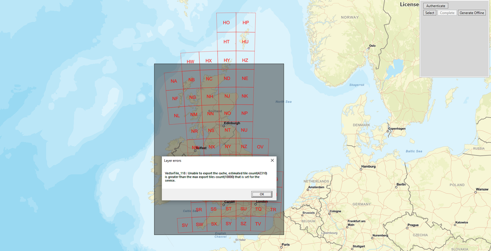

We have signed up for a developer account to test the capabilities of ArcGIS runtime for .NET. The application we need to develop must work in disconnected offline mode. We followed the SDK documentation and using the OfflineMapTask we can generate an offline map. The problem is it only works for small sections of the map. As soon as we try do generate an offline map from bigger selection we are getting an error message: Unable to export the cache, estimated tile count is greater than the max export tiles count (10000) that is set for the service. Our application needs to contain entire UK, Europe and potentially the whole world. Is there a way to do this?

I have created new WPF application, then followed the SDK example to create cache using my application. I draw rectangle using mapView.SketchEditor.StartAsync. I then pass this rectangle to OfflineMapTask like so:
// Create an offline map task with the current (online) map.
OfflineMapTask takeMapOfflineTask = await OfflineMapTask.CreateAsync(MyMapView.Map);
// Create the default parameters for the task, pass in the area of interest.
GenerateOfflineMapParameters parameters = await takeMapOfflineTask.CreateDefaultGenerateOfflineMapParametersAsync(_areaOfInterest);
// Create the job with the parameters and output location.
_generateOfflineMapJob = takeMapOfflineTask.GenerateOfflineMap(parameters, packagePath);
This works fine if the _areaOfInterest is small. If I select bigger rectangle e.g. entire UK, I get the error message I mentioned above.
