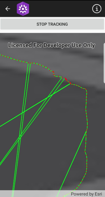

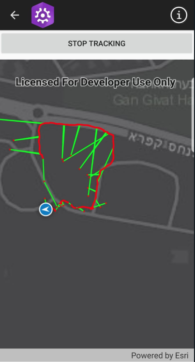

Hi,
I am trying to track location using
LocationDataSource.LocationChanged
event with
SystemLocationDataSource
But this is what I get when I trying it in real devices (android devices)
(as you can see there is a lot of 'glitchs')
Occur in:
Runtime 100.09
Runtime 100.10
Any suggestions?

Dvirus
Hi ,
Solved 🙂 - other yet workaround
I check HorizontalAccuracy before drawing.
But it's still look weird to see the blue circle (my location) jumping and than goes back.
With Google Maps app it's not happen.

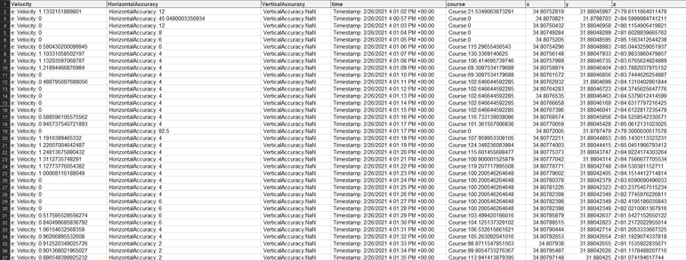

SomeGISGuy
Could you also check what is in the 'AdditionalSourceProperties' dictionary on the location object you're getting, and compare a good with a bad location? This might give us some additional hints about what is going on.
Dvirus
Something like that 😉
Hope it's help.

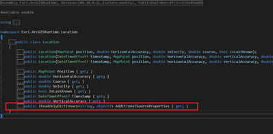

SomeGISGuy
Thanks but that doesn't list any values in AdditionalSourceProperties
Dvirus

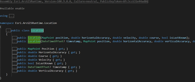

Hi,
I am sorry under namespace Esri.ArcGISRuntime.Location
in version 100.09
there isn't  AdditionalSourceProperties
It's been add at 100.10
