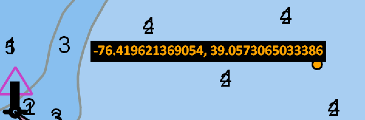

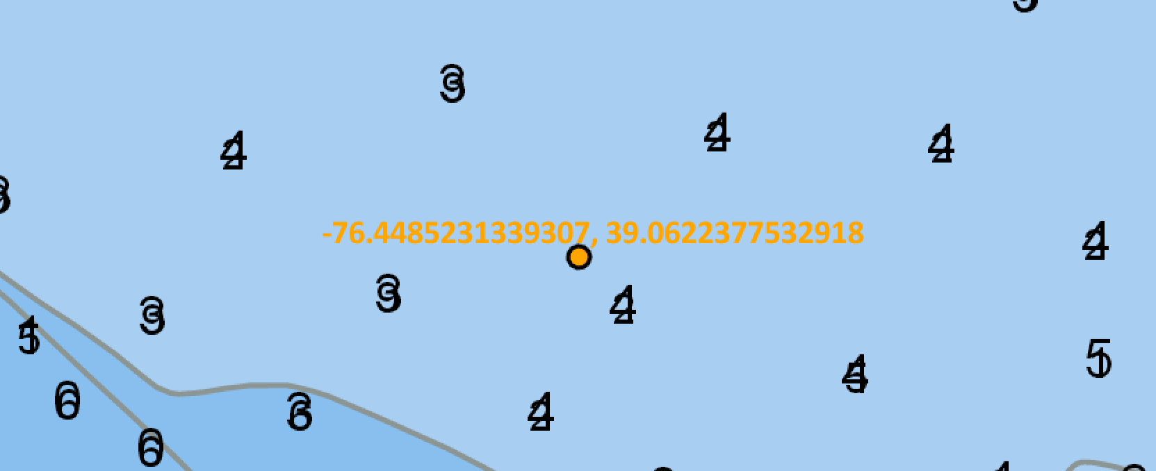

I have noticed that the BackgroundColor property has no affect when rendering is set to static for a graphics layer. The BackgroundColor property works if the rendering mode is dynamic, however, the TextSymbol placement changes. Screenshots and code below (see line 49)
Static Rendering
Dynamic Rendering
