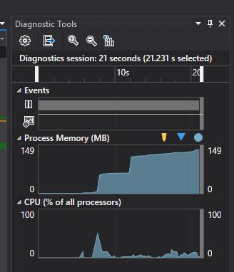

I experimented a bit, this time I labeled features using textgraphics (not the label engine).
About 50 features labeled in 1 overlay, so 50 text graphics not more than 20 characters long strings and I can confirm that the memory doesn't grow exponentially (the RAM grows once).
If the textgraphic is created but not displayed it doesn't affect the memory growth, it's only when the text is diplayed, so if you comment out that particular line of code (adding it in the overlay), the memory will be normal.
Please, check out the screenshots from debugging seesion, I placed a break before (1st screenshot) and the 2nd screenshot is just after executing it.
It's a UWP app, the issue was unoticed on a physical device, I noticed debugging on my dev pc. The window size doesn't affect anything even at full size (2560x1080) and the labels are short strings.
