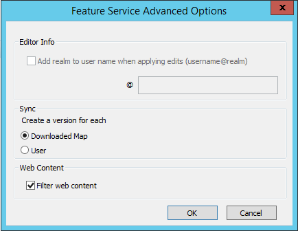

I also select option to create version for each offline map when publishing:

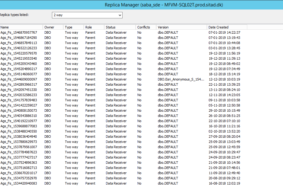

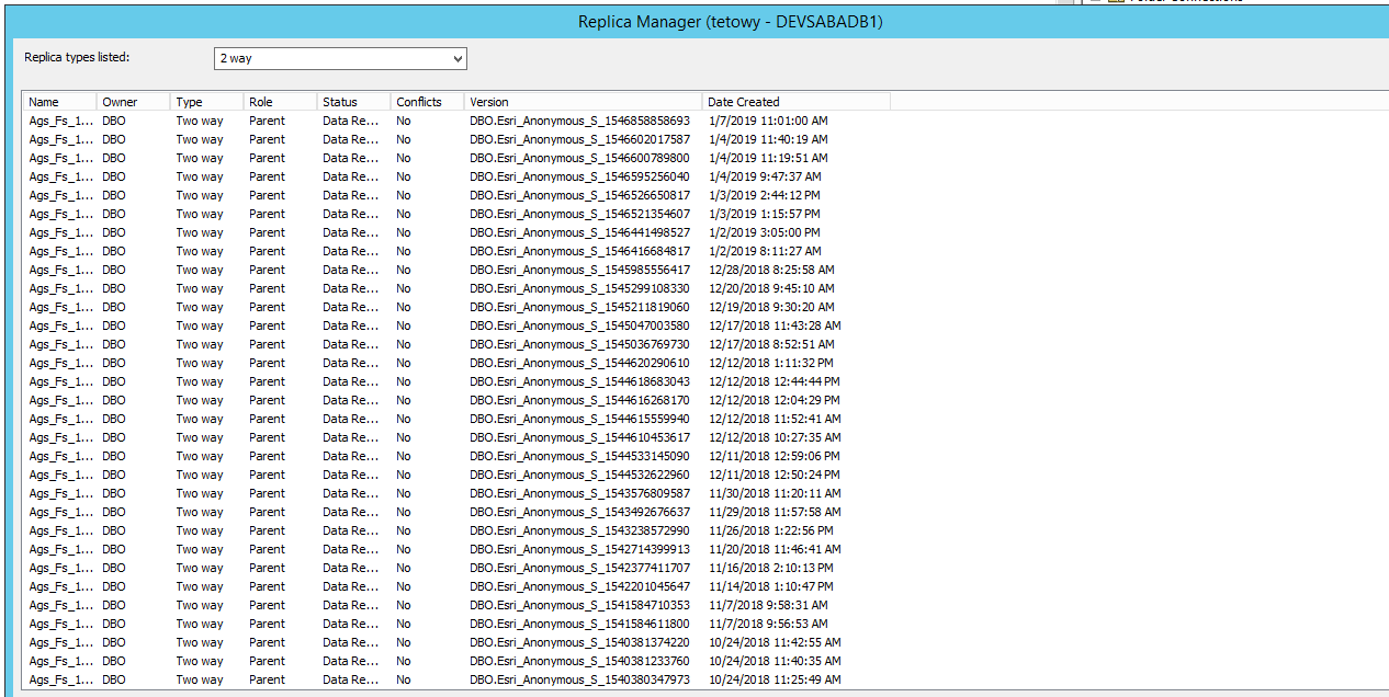

I notice one difference in when I’m listing version in ArcMap:
  1. For a development environment version looks like this:
You can see replicas are created correctly for every version on downloaded gdb.
2. For the test environment it’s like this:
Replicas are created from dbo.DEFAULT version(only one example of creating a separate version), which in my opinion is not correct.
Synchronization for this environment is not working.
