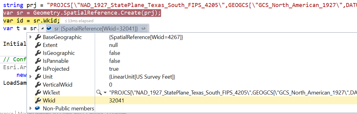

dotMorten_esri
Esri Notable Contributor
This basic sample seem to work just fine with 100.2.1 so it might be shapefile specific
dotMorten_esri
Oh I just realized you're still using 10.2.7, and the simple example above does reproduce the behavior you're seeing with that version.
Anyway you should be OK, as the projection is understood. If you really need the ID, I'd encourage you to consider migrating to v100.x as this is where you'll see a lot of bug fixes and new innovation (10.2.7 is already in extended support which ends in November).
dotMorten_esri
...also if you update the .prj file to contain this instead, it seems to work ok:
PROJCS[\"NAD_1927_StatePlane_Texas_South_FIPS_4205\",GEOGCS[\"GCS_North_American_1927\",DATUM[\"D_North_American_1927\",SPHEROID[\"Clarke_1866\",6378206.400,294.97869821]],PRIMEM[\"Greenwich\",0.0],UNIT[\"Degree\",0.0174532925199433]],PROJECTION[\"Lambert_Conformal_Conic\"],PARAMETER[\"False_Easting\",2000000.0],PARAMETER[\"False_Northing\",0.0],PARAMETER[\"Central_Meridian\",-98.5],PARAMETER[\"Standard_Parallel_1\",26.16666666666667],PARAMETER[\"Standard_Parallel_2\",27.83333333333333],PARAMETER[\"Latitude_Of_Origin\",25.66666666666667],UNIT[\"Foot_US\",0.3048006096012192]]
The only difference seems to be at the very ends of the last few digits. Melita can probably confirm that the comparison has been improved since 10.2.7 to handle small rounding differences, but that seems to be what is happening.

Aaah yes that's a good point. I believe 10.2.7 didn't reproject shape files (v100.x does).
I don't really have any other ideas than try and update the .prj files to something that works. The "correct" string is easy to get with 'new SpatialReference(32041).WkText`
