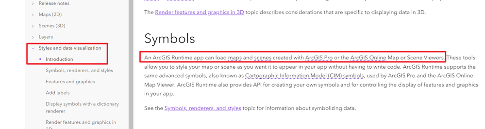

I start my wpf app, load some local data layers, then "save the map". When I start my app next time, I can load the map with layers and everything saved last time. I've tried Map.ToJson(), it seams only save the basic map infomation, but no local data layers. Do I have to write a custom project file by myself? I'm not sure if arcgis runtime sdk support loading map directly from arcgis pro file (*.arpx), and save changes back.
