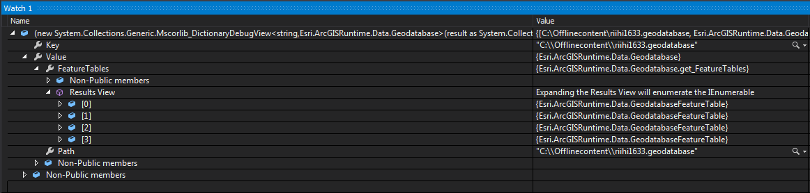

Hi,
I have created a .geodatabase file that has four tables with geometries and multiple tables without geometry. However, when I call "await Geodatabase.OpenAsync(path)" in my application and check the Geodatabase properties, it only has the four tables with geometries inside FeatureTables property. Should the tables without geometry be visible here too? Or is there some other way to access the tables without geometries inside the Geodatabase?

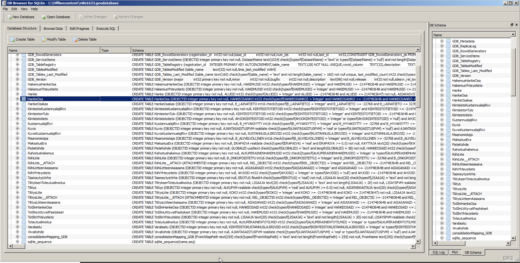

When I check the .geodatabase file with SQLite browser, I can see that all tables are created correctly inside the file.

After further inspection I noticed that tables showing in Geodatabase.FeatureTables property is somehow based on the GDB_ServiceItems table in the .geodatabase-file.
If the .mxd-document used in creating the Runtime Content has tables with geometry, these tables are listed on this GDB_ServiceItems table and only them can be used through Geodatabase.FeatureTables property.
However, if the .mxd-document used in creating the runtime content only has attribute tables on it that have relationships to these tables with geometries, GDB_ServiceItems table does not exist inside the .geodatabase-file and all the tables are visible inside the Geodatabase.FeatureTables property. In this case, the tables do not have ServiceInfo and therefore give that "Schema info not found" error.
I can also replicate this by creating Runtime Content with geometry tables that have relationships to attribute tables. After creating the content, I open the Geodatabase and check that only these geometry tables are visible inside FeatureTables property. Then I close my application and open the .geodatabase in SQLite Browser and manually delete all rows inside GDB_ServiceItems. Then I check Geodatabase.FeatureTables  and its null. Then I again open the .geodatabase in SQLite Browser and delete the whole GDB_ServiceItems table and after that when I check Geodatabase.FeatureTables, all the geometry and attribute tables are visible there but do not have ServiceInfo.
