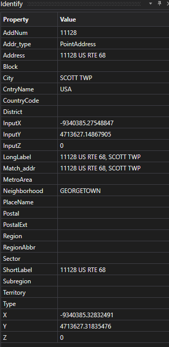

I have an app using .NET Runtime SDK 200.6 for WPF and a MobileMapPackage with a locator created using ArcGIS Pro 3.4.  When I do a reverse geocode on an address point, I'm no longer getting the individual location elements (StPreDir, StName, etc) despite using the following code.
var userLocation = MainMap.APSSMapView.ScreenToLocation(e.Position);
ReverseGeocodeParameters p = new ReverseGeocodeParameters();
p.ResultAttributeNames.Add("*");
p.OutputSpatialReference = MainMap.APSSMapView.SpatialReference;
var closest = await MainMap.BaseMap.LocatorTask?.ReverseGeocodeAsync(
    userLocation, p);
I only get the following attributes:
Typically, this is something that ResultAttributeNames.Add("*") has fixed.  Anyone have any ideas?

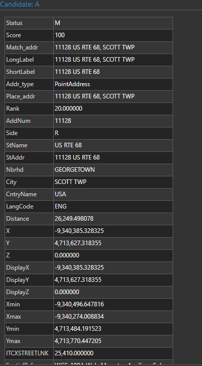

Here is what the same locator result looks like in ArcGIS Pro, which is what I'm expecting:
