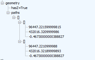

Now i make a query with the ArcGISRuntime .Net (Version 100.15). The FeatureQueryResult contains a polyline with no points:
But when i look with fiddler the response of the webservice request contains the correct points:
Could it be a problem that the line is to short? I hope anybody can help me to find out what the problem is.
